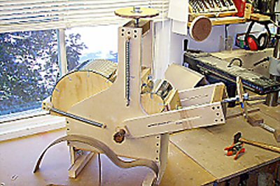

Has anyone got plans for the Fox Style light bulb side bending jig. I love to get blankets, but I think I'd like to try this first and save up for the blankets. I tried to search the archives, but didn't have much luck.
Peter
PostPosted: Fri Jul 27, 2007 12:33 am
Peter I am with Hesh here. I bent using light bulbs for a year or so. I really recommend investing a blanket I really is the way to go. Bulbs have hot spots That make it on occasion frustrating. If You do decide to use bulbs rig your system on 3 600W dimmers Or at least 2 600w dimmers. The waist and upper bouts are so close to the bulbs it is easy to scorch and the lower bout seems to take for ever to heat up. So you want to be able to control the heat independently. I also suggest that you use 3 200W (clear) bulbs. 150W will work but 200W work better.
But the truth is It will cost about $60 for 3 ceramic fixtures, 2 600W dimmers, 3 clear 200W bulbs and a blanket and a variable wattage controller will cost you $120 there about from John at Blues Creek Guitars. So you really don't save that much.

I think this is what you're looking for.
Fox Bender Plans

Try this link for reference, Peter. It`s in the Online Resources at the top of this page.
http://jcjonesguitars.netfirms.com/sidebend2.htm
This style bender does OK, but I`m seriously considering heating blankets.

I'll look into that. I do have a silly question. Is the "press" the same for light bulb bender and blanket? After heating the sides they have to go into a form or press, right? Can I build that and decide on how to heat the sides later?
Just a thought.
Peter
PostPosted: Fri Jul 27, 2007 11:19 am
yes.

PostPosted: Fri Jul 27, 2007 12:23 pm
Posts: 318
Location: Trois-Rivieres
First name: Alain
Last Name: Lambert
City: Trois-Rivieres
State: Quebec
This guy explaion how he did his.
It is in German, but the pictures are English
Was helpfull to me.
Fox Bender built

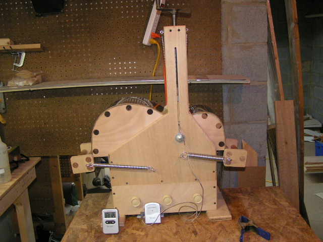

    Blankets are very good for bending.I am a sponser here and stock all sizes for benders. The blankets need to be 5 watts per sq inch. Light bulbs will do the job on most wood but you cannot control the heat and over time will end up costing you more in cracked sides.
    In 5 years of blanket bending and I bend 6 sets a week I lost 2 side sets. With light bulbs it was more like 5% lost . Check out my website and you can download the tutorial for bending there. http://www.bluescreekguitars.com
    A complete blanket rig for 120 is $140 with the controller and thermomter.
john hall
blues creek guitars

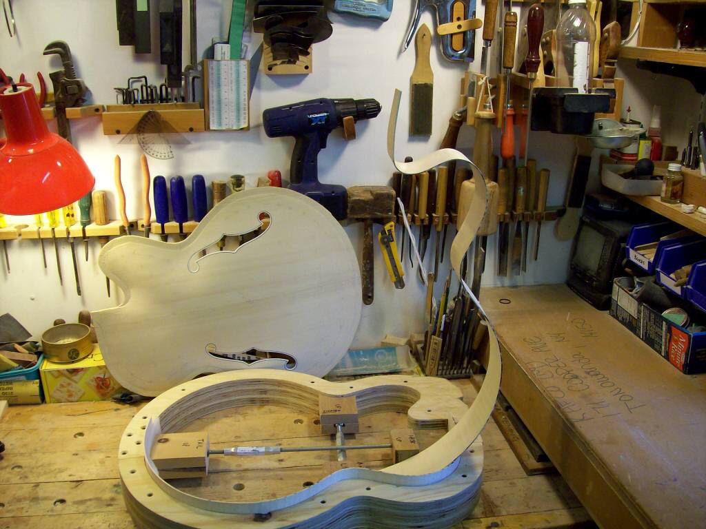

PostPosted: Sat Jul 28, 2007 2:10 am
Posts: 1383
....and in the "bulb" camp.....
Further to my post above, here's a side I took out of the bender this morning. It's a new design for me & I was a bit worried because of the tight cutaway (1" R) and horn (about 1 1/4"). It came out great- no scorching (even with 55 min. start to finish time) cracks or blemishes.
Dave
Milton, ON

PostPosted: Mon Jul 30, 2007 10:56 am
james, sorry to get back to you so slowly.
the last one i got was an omega srm 050636. it is a 5w/s.i., 6" x 36". you can easily look them up on omega's web site.
